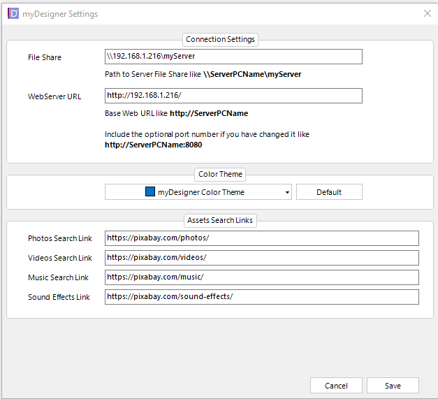

  6. Step 6: Once myDesigner 6 starts up, configure the settings form for the IP of myServer controller.
  8. File Share: "\\yourSERVERname\myServer"  If your list of myServer template folders doesn't populate, then it's likely that your Windows computer doesn't allow for connection.  Paste the same URL into Windows File Explorer.  You might need to add "allonis / allonis" user credentials to Windows to enable connection.  If you are having issues, particularily with Windows 11,  right-click on Windows 11 start button. Choose run.  In the Open text box enter \\[IP ADDRESS]\myServer and click ok. Are you prompted for credentials? If yes then enter allonis / allonis and make sure to click on remember. If no then does that open the share and you can browse files?
  9. WebServer URL: "http://yourSERVERname:80/" Modify the port number to be same as what you are running myServer's web server on. Port 80 is the default and it is not required to be typed in the URL. Click Save button.
  10. Step 7: Click the SAVE button and Connect. myDesigner 6 should now be running and your list of web apps should be listed on the left side.

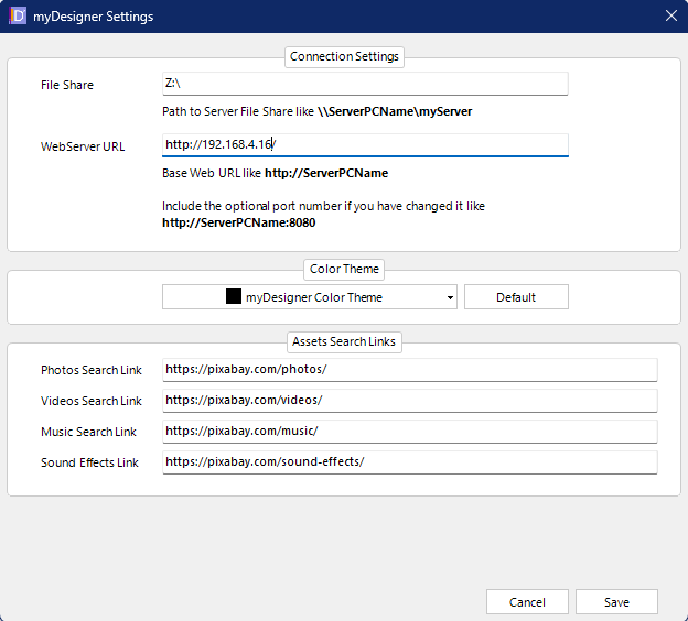

then go to myDesigner
Set File Share - Z:\
Set WebServer Url - http://<<myServer> IP Address>>
click save
