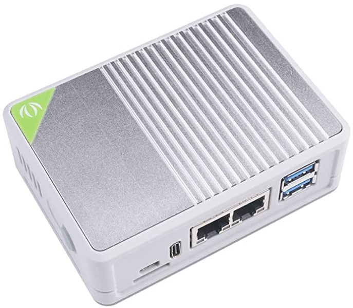

myServer Router.  It contains Allonis's flagship control system myServer.  It also has networking hardware and software that helps solve the most common control system issues - ethernet networking
It does this by connecting to your current Internet accessible network via it's "LAN1".  It gets it's IP address automatically from your existing router / firewall.  This gives Allonis Internet access to manage the system remotely.
The myServer Router has LAN2 port.  This plugs into your Control System ethernet network switch.   All of your control devices (Video matrix switch, IP TVs, IP2IR hardware, DirecTV receivers, Roku devices, mySignage Server and Players, myAudio players, myMediaPlayers etc) connect to this network switch.
The myServer Router then manages all of those devices IP addresses by it's own DHCP server.  myServer can then automatically discover devices to assign into Device Groups (ie: DirecTV receivers) to help organize the system.  Since myServer then has all control device IP addresses, it can than communicate with them and control them (assuming compatibility).

Open the package and put the myServer Router on a shelf that has cool flowing air.
Connect the LAN1 (right most and closest to the USB 3.0 connectors) to the ethernet network switch that all of the control devices will be connected to.
Connect the LAN2 (furthest from USB)to the existing network that has Internet access.
Connect all DirecTV, IP2IR, Video Matrix Switch, Audio Matrix Switch, TVs to IP control etc to the control ethernet network switch.
