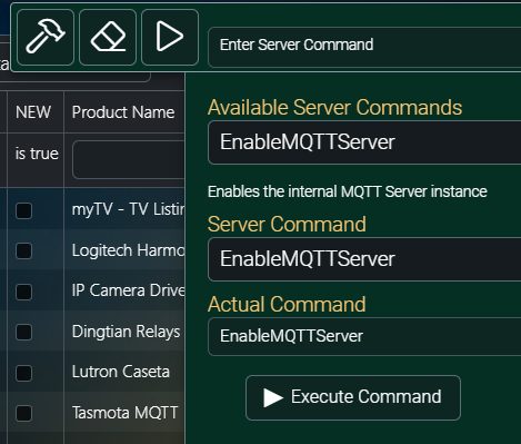

Enable MQTT server on myServer in Command Builder. FYI: Default port is 1883
