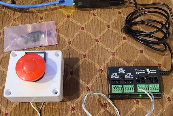

The button is a simple momentary contact button that is wired to an iTach Flex Sensor adapter. Here is how it is wired:

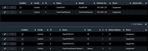

Then, in the Global Cache myServer driver, set the iTach Flex like this:

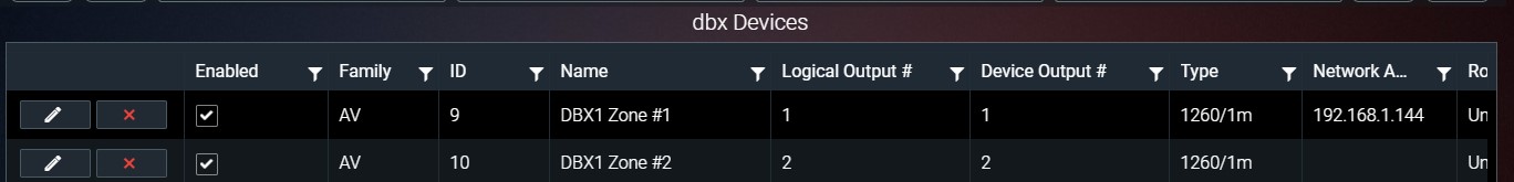

Here is the MediaPlayer Driver setup:

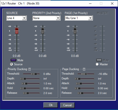

Here is the DBX setup:
Note you can also within the DBX software configure Microphone / Line In Ducking to prioritize the media file audio over the top of the current audio source. The current source then fades back in when the media file audio is done playing.
We used -16db threshold setting.

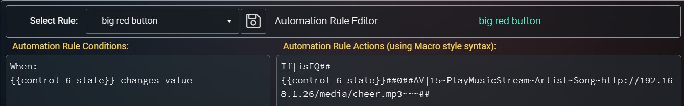

Once you have the audio setup, then create an automation event like: (Note ipaddress should be that of myServer not myAudio player)
So, when the Button is pushed, the Flex sends a signal to myServer that the contact was closed which the GlobalCache driver changes a variable state (control_6_state in this example). This then fires the automation rule action that tells myAudioPlayer to play the mp3 audio file.
