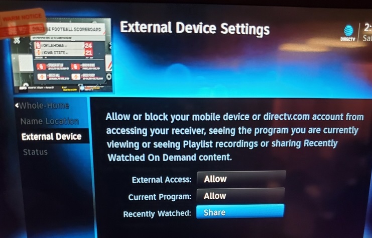

2) Configure the DirecTV receiver(s) by enabling "External Access" in the Menu / Setup / Network.
"If you’re using DIRECTV® Whole-Home DVR service, use this option to name this receiver location. Select “Whole-Home”, then “Name Location” and follow the onscreen instructions. To learn more, read the “DIRECTV® Whole-Home DVR service” section in Chapter 3. Use the “External Devices” option to allow mobile devices to access content on your DIRECTV receiver, including the ability to see the info for the currently tuned program, and tune to a channel. The “Status” option shows whether your account is authorized for Whole-Home DVR service, and how many receivers are found on your network."
Check to see if your DIRECTV Receivers are networked: Press the DASH button on the remote. The screen should say, SWiM CONNECTED and INTERNET: CONNECTED. If it is not “SWiM Connected” or “Internet: Connected,” ensure it is network connected.
Check to see if DIRECTV Receivers are enabled for the External App: Press and hold the INFO button on the remote until the System Info & Test screen appears. Select WHOLE-HOME. Select EXTERNAL DEVICE. Change all options to ALLOW. Options could include EXTERNAL ACCESS or CURRENT PROGRAM.
"External Access" / "Access Current Program" has to be allowed.
"Current program" has to be allowed.
"Recently watched" Shared.

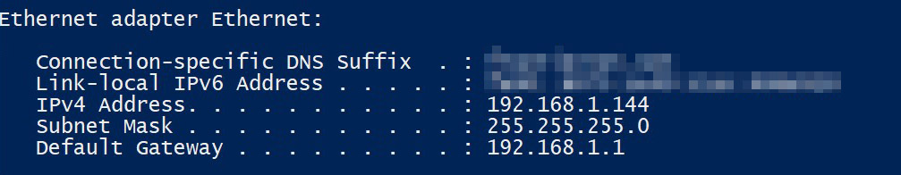

  • From a PC, press [Windows Key] + R and type powershell then press the RETURN key.
  • When the window pops up, type ipconfig and press the RETURN key.
You will get a lot of information. The top set of information is what you’re looking for. It should look something like this:
Screenshot 2022 07 08 120847https://blog.solidsignal.com/wp-content/uploads/2022/07/Screenshot-2022-07-08-120847-300x58.jpg 300w, https://blog.solidsignal.com/wp-content/uploads/2022/07/Screenshot-2022-07-08-120847-768x149.jpg 768w" alt="" width="1007" height="196" class="wp-image-34418" style="height: auto; max-width: 100%; margin: 0px; padding: 0px 0px 15px; border: 0px; font: inherit; vertical-align: bottom; box-sizing: border-box;" decoding="async" />
This is the information you are looking for. Your IP addressing scheme is the first three numbers of the IPv4 address. In this case it’s 192.168.1.x, but yours might be 192.168.0.x or something else.
Take note of the subnet mask and gateway, you’ll need that when you set a new address.

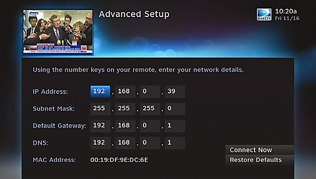

You will see a screen similar to this one:
ip addresshttps://blog.solidsignal.com/wp-content/uploads/2022/07/ip-address-300x170.jpg 300w, https://blog.solidsignal.com/wp-content/uploads/2022/07/ip-address-768x436.jpg 768w, https://blog.solidsignal.com/wp-content/uploads/2022/07/ip-address-180x101.jpg 180w, https://blog.solidsignal.com/wp-content/uploads/2022/07/ip-address-120x67.jpg 120w" alt="" width="1024" height="581" class="wp-image-34419" style="height: auto; max-width: 100%; margin: 0px; padding: 0px 0px 15px; border: 0px; font: inherit; vertical-align: bottom; box-sizing: border-box;" decoding="async" />
This will let you set that static IP address.
  • For IP address, use the first three numbers of the IP addressing scheme, that you got earlier.
  • For the fourth number, use something out of the DHCP pool, if at all possible.
  • For subnet mask, use the subnet mask that you got earlier.
  • For default gateway and DNS, use the default gateway you got earlier.
When you are done, press “Connect Now” and there will be a short test. If you’ve done everything right, it should all work and you will be connected.

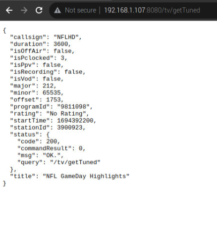

To confirm the DirecTV boxes are correctly setup, you can use these URLs via any web browser. For this example replace the text a.b.c.d with the ip address of your DTV receiver. If either returns 403 or a 50x status then permissions (see above) are not set properly or the ip address is not correct. There should be no need to reboot the DirecTV receivers after making these settings.  But also no harm in doing so either.  It just takes a while for them to fully reboot.
This validation step is required to confirm each DirecTV receiver is properly setup when Allonis is commissioned to program the system to save time.
http://a.b.c.d:8080/info/mode
or
http://a.b.c.d:8080/tv/getTuned
The latter should return current program content information.
Verify each DirecTV receiver is setup correction by going through the list of receivers per the config spreadsheet and entering
http://192.168.1.104:8080/info/mode
from a web browser.   If you get content information back then that one is good, If not, then you need to investigate. Change the ip address for each DTV receiver accordingly.
Once you’re done with that, then go through each DTV receiver and attempt to change to channel 100, wait for the user interface to update the channel info, and then change the channel back to whatever you want.   This tests each receiver.
Keep in mind that the DirecTV receivers may be displaying video, and just because they display video doesn’t guarantee that they are responding to network requests. If they do not respond to network requests then they are not accessible to take commands from the control system.
You can verify if the respective DTV receivers are functional via opening web browser and entering the following ip address. Just change the ip address of each DTV receiver. DTV 1 is 192.168.1.101 – DTV 8 192.168.1.108. When doing this from a web browser, you will get the “now playing” info from the DTV receiver. If offline, then you will get a “This site can not be reached” error.
gettuned

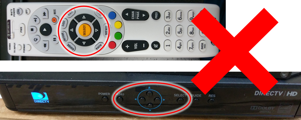

If you are experiencing an issue or “Out of Range” when connecting your DIRECTV Model H24-700 cable box into our XMP-6400, the solution is to change the output resolution using DIRECTV box’s front panel button instead of using the remote control.
 Follow the following instructions to configure the DIRECTV H24-700 box:

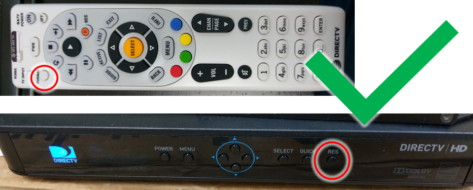

  1. Connect DirectTV box to the video matrix transmitter’s input.
  2. Press 2 times on the RES button, then wait for 5 seconds.
  3. If it still shows “Out of Range”, then repeat “step b” until you see an image show up on the screen.
The DIRECTV box outputs a 480i resolution by default (which may not be supported by the video distribution matrix). You will need to connect it to a screen, then switch the resolution to 720p by pressing the “RES” button on the front panel. You will see the screen shows 720p, then you can connect it to our media player:

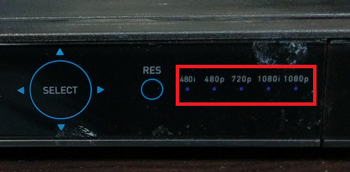

  • The DIRECTV box will lose its setting once you unplug the power, so if you move the box to another location, you will need to reconfigure the resolution again.
  • The front panel “RES” button is very difficult to use. There is no LED light indicator (circled in below) to signify which resolution is selected. If you connect the DIRECTV box directly to the video matrix transmitter and then select the resolution, remember to press “RES” button 2 times (like mouse double click) to switch resolution. The first press will show current resolution, and the second press will change to next resolution. Switching the resolution will take about 5 seconds to take effect.
    mceclip1

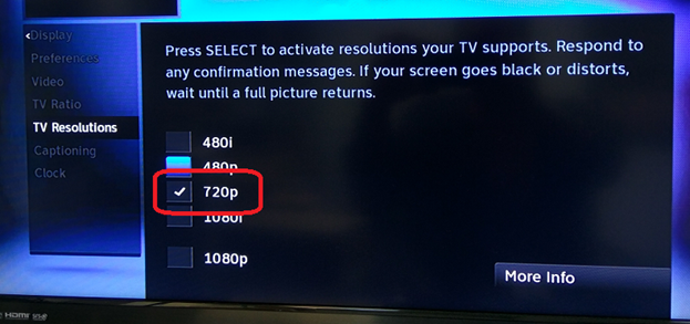

Although configuring the resolution through the cable box settings using the remote does not work, we suggest to configure the setting to only activate 720p.
Another way to confirm is to check your TV or monitor for the input resolution. Here, the box is configured to activate 720p resolution using the box's internal settings. However, we can see that the monitor is receiving a resolution of 480i from the DIRECTV box.

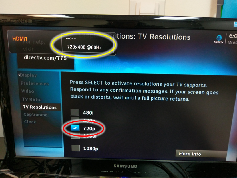

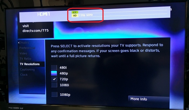

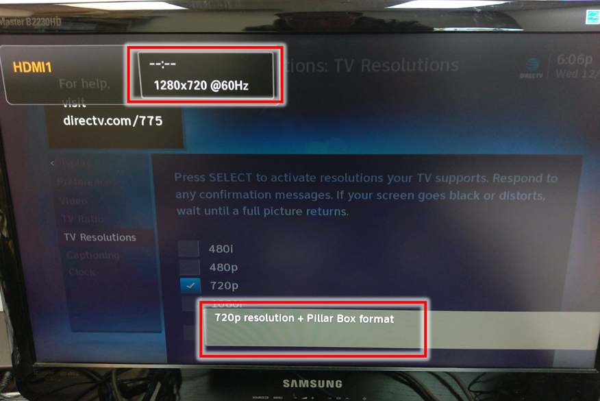

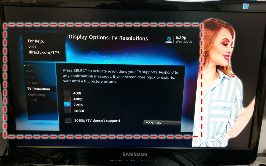

Problem: The selected resolution is not the actual output resolution!
If you select resolution using remote control or the device buttons to browse through “info & test” -> “Display” -> “TV Resolution” then make a check on the 720p box, this will NOT set the H-25 to 720p!
For example, if you look at the image below, the yellow circle shows the actual resolution from HDMI1 (e.g. 480pH) while the menu is already selected to 720p (e.g red circle).
If you use arrow and select buttons, you will not configure the actual resolution of the H-25:
The right way to configure H-25 to 720p is to use the “Format” button on remote control or the “RES” button on the H-25:
Once you click those buttons, it will loop you through the resolution and you will see a resolution info pop-up on screen (e.g. in photo below, both screen resolution and H-25 resolution are matching)
Then you can connect the H-25 to video matrix transmitter:
