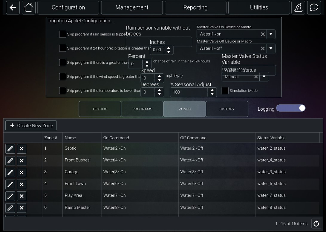

Within the Irrigation App, click on Zones.
Create New Zone.  Type an On Command that turns on the relay of your choice for that water solenoid.  Do same for the Off Command.  And add the name of the variable that tracks the status of that relay.
Here is an example
Zones
 More typically the On command will look like:
Control|1~On
and the off:
Control|1~Off
and the status:
control_1_status
Advanced:
The above example On / Off / Status commands is an advanced implementation where the relays are on a secondary myServer 6 controller while the Irrigation App is on the primary myServer 6 controller.
There is a macro on the primary myServer controller called "water"
Macro|
SetVariable|water_<p1>_status~<p2>!
GetURL|http://192.168.1.94/api/docommand?command=run%7C16relind~7%20write%20<p1>%20<p2>&client=myServer6_1
Explanation:
The IP address is for the secondary myServer that is actually controlling the relays.
The "%7C16relind~7%20write%20<p1>%20<p2>" Is a command that runs in a "command line" to interact directly with the relays.  This is custom for your particular system.
The "&client=myServer6_1" is the clientname example that the command needs to reference which client sent the command.

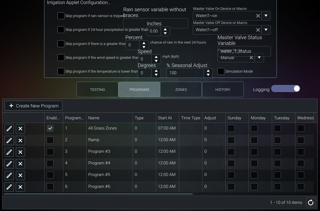

 Create a Program:
Programs
Once you have a Program defined, the rest of the configuration is done in the client user interface.
To access the client, in SheerTablets (example), from the Home page, click the More button (...)
Click the Irrigation link.
Here you can select to put the system in Automatic (on schedule), Manual or Off
You can also define a schedule by clicking the Define Watering Schedule button.
Or you can Manually trigger a program to run.
