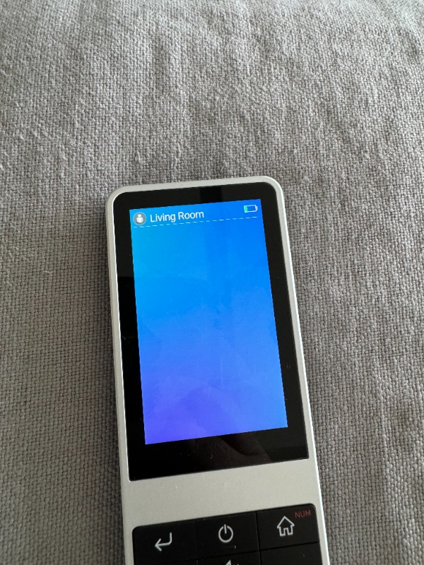

Smartremote screen "empty" but kind of works on browser
RoyN's Avatar Topic Author
  • Posts: 69
Re: Smartremote screen "empty" but kind of works on browser
#627
Did you happen to remote in and check? If so did you rename it?   I'm still getting the same behavior... I see the sample folder and the "non sample" one, through myDesigner so I guess you fixed that.  Nonetheless, the remote still shows "Living Room" and a blank blue screen under.... Through the browser I see the icons for all the sources (even those that I dont have and that popped up at the last update), but clicking them doesnt do anything.  Also, if I try to change rooms from the browser I get the "No Data" message like on the remote despite having 2 created rooms (and some that were already there).
Also in the AndroidTV driver power test screen the smart remote is showing a red X...not sure if this has any debug value...
#659
No dice... the network is connected correctly, and I was able to reach it via ADB and check the myServer IP is correct and so is the template name...
Edit: the sources highlighted in red just appeared after the last update...
Roy, in the webpage view of the smartremote project, you haven't selected a room and the icons for Unknown room are displayed
In the Smartremote, you have which filtered all icons out because your devices are not associated to a room.
Yes, we can help you get this all working.  I will need to log into the system to see where things are at.
